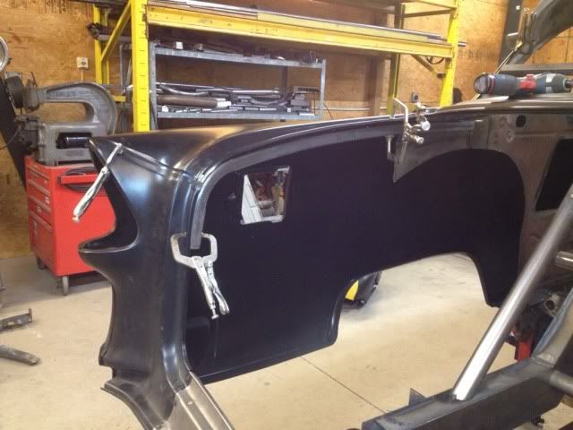

Well, I finally got to use my new tube roller. This is just one of the jobs I had in mind when I purchased the roller.
I started by marking the center Of the tube so I could track it with the cardboard template. I ran a slight radius to start.
After rolling a bit more, then checking it with my template.
I know after a bit I'm going to have to switch to the tube bender for the hard radius.
Here's what it looks like in place...... Being this was my first roll and bend this might end up being a test piece.
