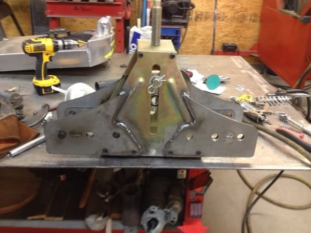

The other day I headed to harbor freight for a tube roller, and got side track on posting the Stretcher/Shrinker's.... Well anyway I brought home the roller the same day and ordered a wing set and billet dies from Swag Off Road which really upgrades the roller far beyond the HF tool itself. So here's what I got :)
Here's the bender from HF
Here's the kit from Swag ! !
Now these guys did a great job with the kit and comes with a great set of directions.
I had to weld the supplied spacers, on the 1/4 inch plates
They have a slot in the back of the plate to weld the spacers to and I used the 20 mm shafts from HF to keep them in line.
Here's what they look like all welded.
Here's one set of the wings welded in place.
And both sides...
