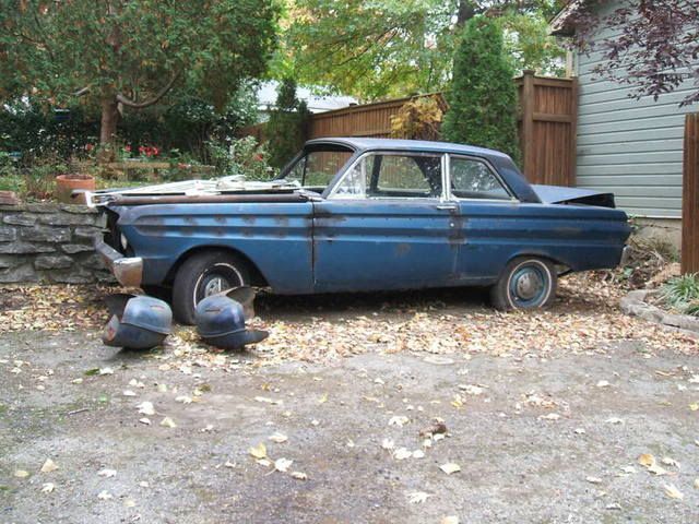

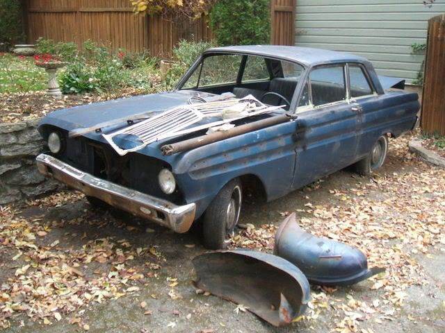

Thought I'd start a build log for the car the club bought. As I said in my intro the car was sold before it could get finished. Just thought I'd share a little of what we did.
11-08-07 Scroungers Car Club bought this 64 Falcon as a project to get us out of the garage and on the track. It didn't look like much. This is how it was bought.
