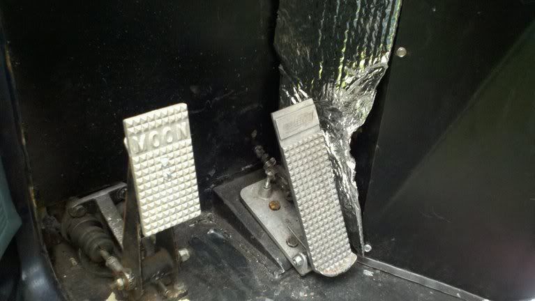

It is something that really needs to be done not only for giving us a better seating position but also much needed "space" between the existing firewall & the headers.
As it is now there is practically NO CLEARANCE at all which causes extreme heat to be transferred into the interior.
This picture tells it all..... melted the Dynamat right off!!!!
