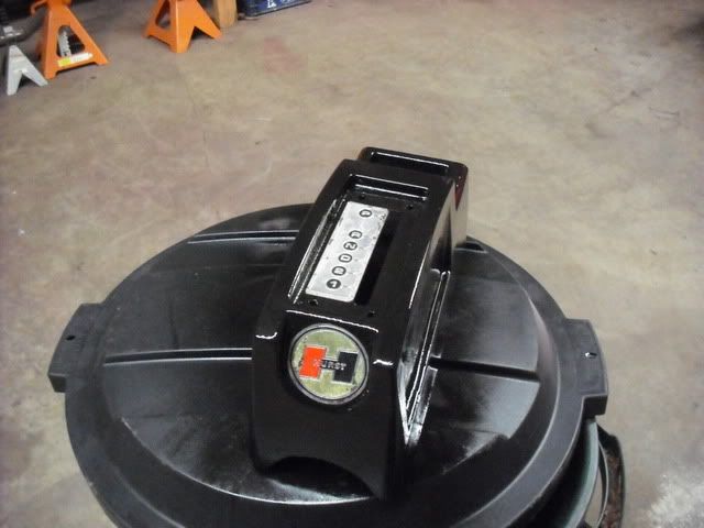

I scored this '60s Hurst Promatic.
Im only using the cover. Wifey's car is running a 'glide,but the cover is big enough to hide the "Quarter Stick"

I'm using a newer B&M Mega Shifter, that's rachet or regular, and this is one area I wont go nostalgic on, as the old shifters all had issues that could mean a overevved engine, or blown trans. I simply built a aluminum bow to cover the shifter guts, as I didn't like the modern look of the B&M plastic box. It works great, and that's more important to me.
Yeah, safety will always have priority over originality or period correct. I just missed bidding on one of those Hurst ProMatics on ebay last month. I'll have to keep my eye open

I think if I end up going automatic, I'll pick up one of the ProMatic 2's, (since the original PM's seem to be a rare find), set aside the modern case, and mount the guts in a homemade sheetmetal box. From the looks of it, the PM-2's shifter can unbolt from the works, and I'd probably convert a short, straight Hurst 4-speed shifter and an era specific shift knob to give it a period correct aesthetic, with the modern ratchet action hidden inside.

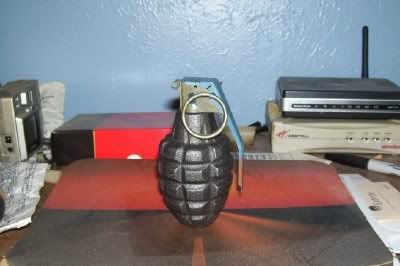

Though I'm sure it's been done before, here's something I've been thinking of converting into a shifter knob....
Although, maybe using a grenade as a shift knob for a high performance transmission is just tempting ironic fate! LOL
