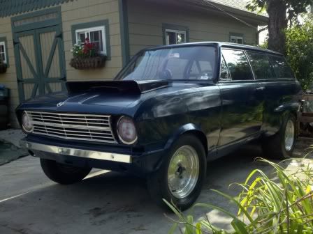

From the first time I ever saw an Opel Kadett I thought they looked like miniature versions of a 1st gen. Nova. The day you first posted a pic of your's I thought the same thing again. That's a classic body style, and a very nice basis for a gasser style ride.
2
Thanks..... This car will be a "keeper". Have already started getting "stuff" done so we can get it back on the street and catch a few shows & cruises before the weather changes.
So far got the "slicks" off it and Mickey Thompson drag radials mounted..... also got a "temporary exhaust system" mocked up.

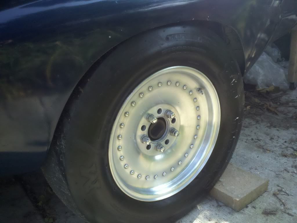

Are the rear fenders flared? Looks kinda like it from the picture. Really nice looking!
From a distance the overall "look" of the Opel is that it came this way from the Factory.
Whoever installed the flairs (no I do NOT know what they came from) did a GREAT job. They do NOT look like they were added-on. They not only fit the wheel/tire combo perfectly but also the bodywork both inside & outside shows no signs of them being added.
You can notice the that the "CenterLine wheels" (10" x 15") have a LOT of backspacing..... 7 inches" to be exact! I have never seen rear wheels with so much backspacing. They need to be!!!! The rear leaf springs are still in the stock mounting position which limits the how far the rear wheels/tires can fit under the car without making contact with the leaf springs.
For NOW.... this setup is just fine. Like the old saying.... "if it ain't BROKE don't FIX-IT"!!!!!
Eventually I plan to make a new rear sub frame and either move the springs "in-board" or to eliminate the leaf springs & convert to a coil-over setup which will allow me to use a more "standard type wheel" (with more common back spacing) and of course larger tires.
Currently the drag slicks are 10" which look OK....... the Mickey Thompson drag radials for the street are almost 9" wide & are NOT as tall so they will have to do for now.
I would like to have around 12" tires on the rear someday ...... the "SOMEDAY-list" gets LONGER EVERYDAY!!!!! HA!!!!!
