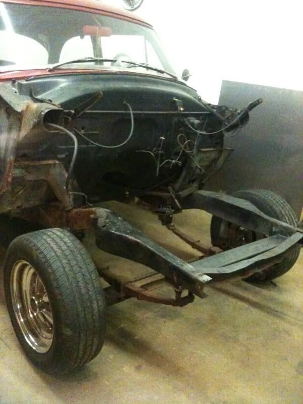

Sorry guys been workin late & goin to bed early. Heres a few pic's of what I'm workin with. The steering box is rear mount just in front of the firewall and I hope I can use it in the stock location with little modification.
After having a look at that frame, I'd be tempted to blow that engine crossmember out and keep the rails and box them. But, it would probably be much simpler to stub it. Decisions, decisions.....
Im pretty sure I'm capable of stubin' it but just not sure how to go about it. I guess Im worried about getting stuck on something I can't figure out. I think the stock frame cleaned up & boxed and maybe extended a little may look pretty good. This will kinda be a learn as I go project & don't want to get in over my head, but don't want it to look weird either. I think mt94ss front frame work looks really good. If mine will come out as clean as that I think i would be happy with it. Thanks everyone for the input & pic's. Anymore input is greatly appreciated & needed.
I agree with Str8axle. I think I'd chop out the crossmember, box in the portion of the frame that's not presently boxed, and then fab up mounts for the straight axle and new motor. You can get it looking clean and streamlined without having to stub it.
Rear steering box will most likely work with your drag link at the rear, and your steering arm bent down to reduce angle and bump steer.
I would anti up on that also, I believe the front K-member is riveted in, just grind the heads off and drive them thru with a punch, that way if things are not looking like your not liking the outcome you can always bolt the crossmember back in, anyways I believe you can box the front, build in a set of engine mounts and suspension mounts without to much of an issue.
Ok guys I've been throwin' around ideas for a while and think I have a game plan. I going to remove the center Big Ugly crossmember then clean, smooth & box everything ( like y'all suggested) and weld in this engine crossmember from Speedway...
then, I'm going to take the very front crossmember that the front end bolts to (in the picture, the very front support with that center bracket)and flip it around & box it in to give the frame that boxed in look I like. I also will be ordering (if everything goes as planed) the Speedway Gasser straight axle kit with Chevy spindles. What do Y'all think?
