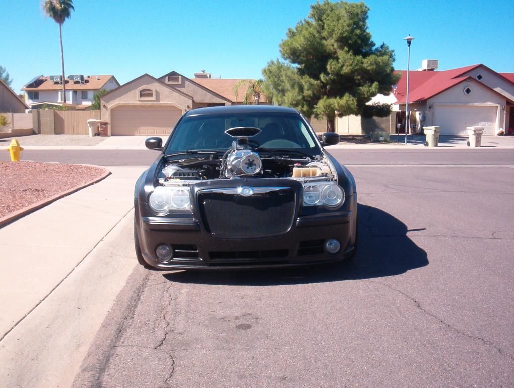

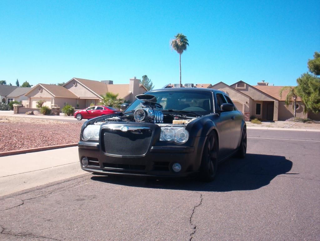

My son Matt has been modifying his '06 Chrysler SRT8. He's painted it flat black with "PlastiDip" rubber paint, and added a 6-71 blower. It's running two stock SRT8 throttle bodies but he has only opened the mounting plate for one throttle body until he can figure out a way to make both bodies work off of the drive by wire gas pedal. There's a guy that is making a small computer unit to do that but Matt is working on his own unit, just hasn't gotten it done yet. He's going for the Mad Max affect so he found a maker of the Scott Blower Scoop just like the Mad Max car had too. So far he has painted it with the plastic paint, flat black. Shaved all of the body emblems off. Shaved the rear door handles and installed rear door poppers. He has modified the front grille. It's very subtle but he deepened the inside of the opening and set the new grille deeper in. He's lowered it all around too. He's installed a bigger cam and injectors and he has a dual tune in it. He can change it back and forth from gasoline to E85. Before the supercharger he was well over 550 HP and now IT IS STRONG!! But he is only around 6 LBS boost. Anywho, here it is.
My wife took a cell phone vid of me taking a ride in it but I have to get that from her.
