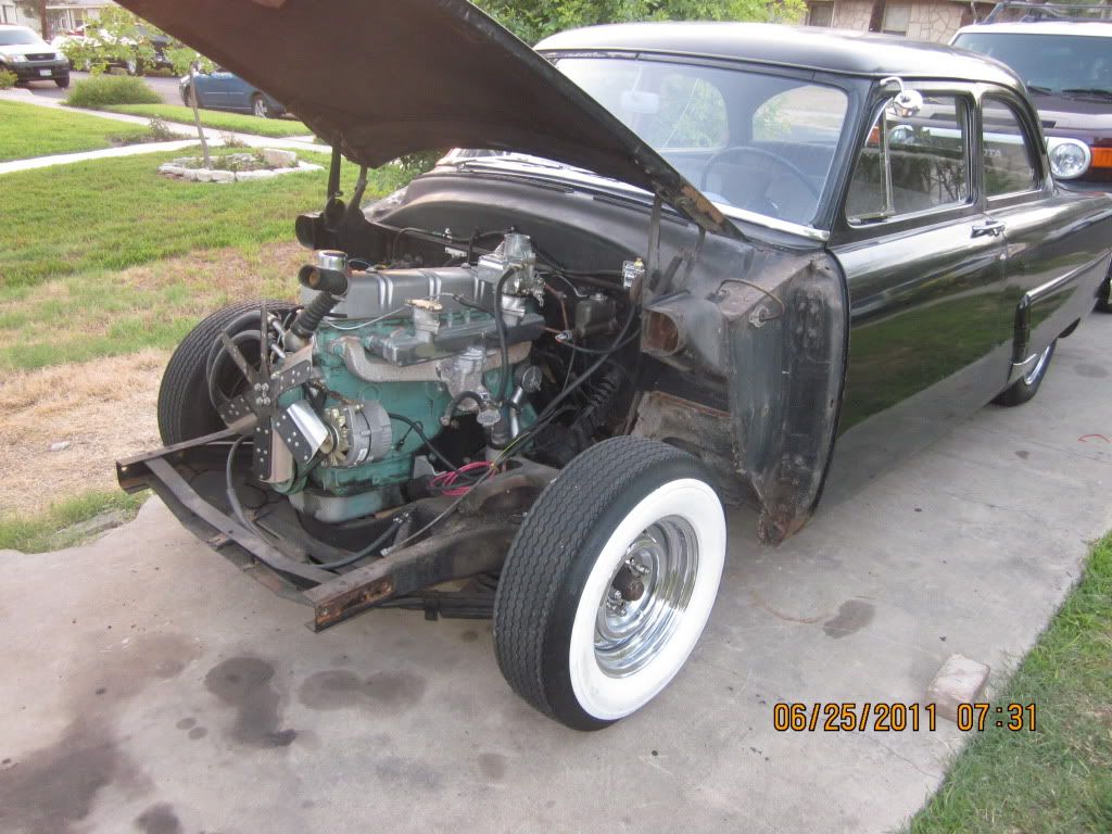

Well I got the engine & tranny out today (223cid I6 & 3spd on the tree). I'm off tomorrow so will start the boxing & cleaning up the frame process, need to come up with a plan of attack & take lots of measurements. So here is some pic's with the engine out & a couple of pic's of the 355cid SBC thats going in it.

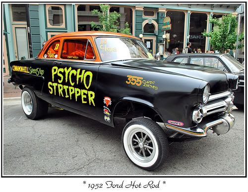

Mark this is the stance I want..well cross between the two.. I dont want to radius the wheel opening cuz I like the fender opening & the way it flares out and I dont want to take away from that, but ya never know I may change my mind later. I think it will still look right. Look at this '52 Ford and this wagon.

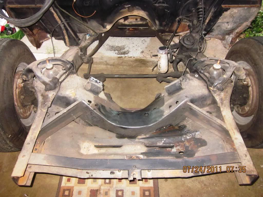

More progress today, I removed all the old front suspension stuff today and started scrapping & wire wheeling the frame. Although I didn't get as far as I wanted (58yr old rusted bolts = torch & PB Blaster), I'm happy with my progress. I'll post some pictures up tomorrow.
Yep those old bolts can be a pain! I was actually glad when some of mine broke, as it ended the ordeal. But some of mine were captured nuts and couldn't access the other side! I had to drill and tap the broken bolts out to be able to reuse some.

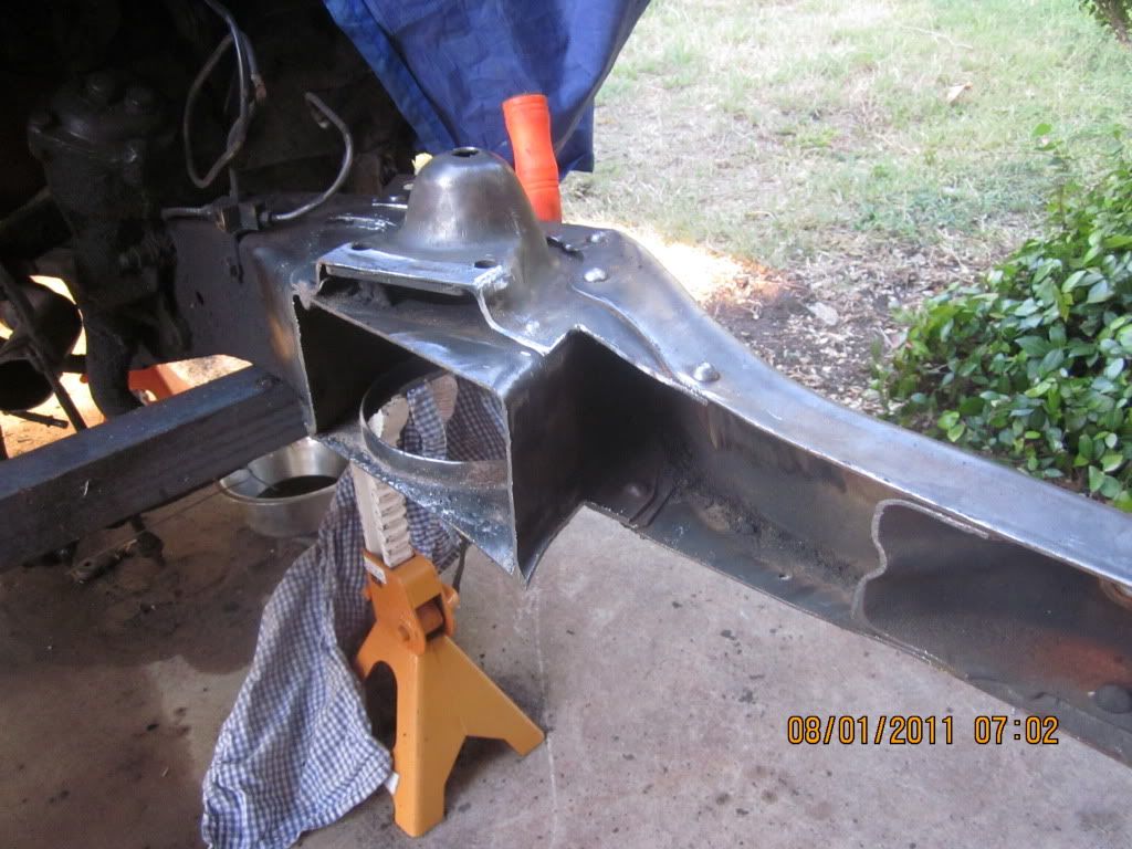

Well..... I played hooky from work today & managed to get a little further & Gees is it HOT!. I guess the hardest part was planning all the cuts & trying to keep it as square as possible at the same time. Here are some pic.'s of the progress.
I need some help figuring out what to do to the front... square box it in?, round bar across the front?, bullnose it? Decisions...Decisions
How heavy is that hunk of crossmember you took out?
Are you trimming any more from those spring pockets?
That looks great. I would trim off the rest of the pocket/perch and box the frame in all the way to the front. You can round off the front of the frame and use a piece of tubing about the same size as a front crossmember. There are several 'universal' engine crossmembers depending on your powerplant. That should make it strong enough. You are running a straight axle, right?
p.s. Don't mind my mad graphic skills on the photo. But this is what I was thinking to cut off. It would clean it up alot.
I think I'd cut the heads off all those rivets and then just knock that whole spring pocket out of there. You wont need any of it for the axle or the shock mounting.
