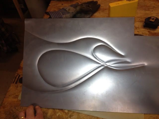

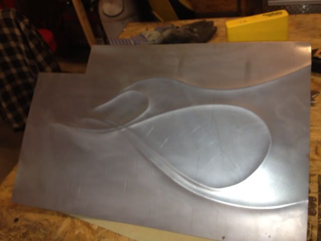

I was playing with my large English Wheel an was messing with another die I have for tipping. Had to do it by hand there's no power so you have to draw with the sheet metal...
I'm thinking of doing this on Stainless with the flames facing up and put it behind our cook top as a back splash ! ! Wonder what my wife would think ? ?

John, most the time, guys do stuff like this with a bead roller, but I set my tipping die in my large throat English Wheel and just gave it a whirl. The tipping wheel is most used for tipping an edge on curved panels that are impossible to do in a metal brake.
Tom says I should do the whole side of the Grump and leave it in raw aluminum.
The only problem I'm having doing the flames behind the cook top, is I am putting a back splash behind the sink area also, but don't want flames there. Now it is all the way across the room and wondered if I don't tie the same design it won't look right. I could do a pleated design but even thought of a vine design ?
Here's the tipping wheel for those who haven't seen it. I got it back in the early 2000's when a friend had just started making them. Joe is one heck of a talented machinist. It's made to adapt to my large throat wheeling machine.
