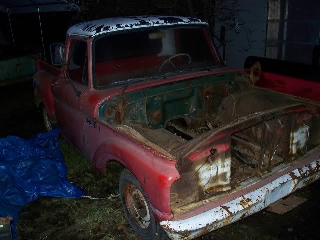

here's where we started

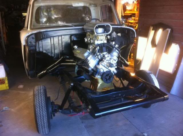

'93 Mustang engine with a t5, a bunch of body work, over arched front springs, a posi and some big ass radials out back; best time 14.71
for '11 a complete re-do with a built 306 with aluminum heads, 10.5:1 compression, roller rockers, a tunnel ram and some other go fast goodies, 406hp/373fp

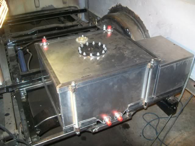

tubbed and shortened the box as well as added a fuel cel and re-located the battery box

Absolutley outstanding. Looks like a heck of a lot of fun. Introduce yourself in the intruduction section and tell us about yourself and your plans. Glad you could join in. Mark L
Sorry, I looked at this post before seeing your introduction. Regardless, the welcome still stands. Keep us informed on your progress. Give us some specs on the small block, plus what RPMs you're using? Again, good to have you on board. And I would love to hear/see your truck run when you get it dialed in. Vids are great. Mark L
