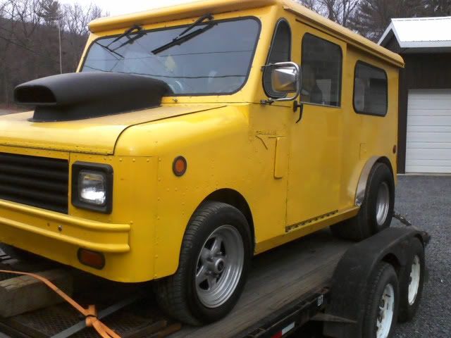

I've been looking for a cool old ride that had enough room in it for my four legged kids Toby and Annie . :anim_60: well I finally found it and it will make a great show goer ! !
It should be economical it's running a 454 with a 400 turbo and a nine inch rear with 456's. The engine is suppose to be from a 70 Chevelle and supposably has 490 hp. Well if it had 250 horse power it would most likely break the tires loose. :anim_60: :rofl:

Well my plans are to run it for this season just as is it with some upgrades which I will explain shortly. Ok as far as the scoop my son love it and tells me it growing on me. OK ! ! In his mind. I'm looking to build a whole new hood but as a cowl hood. I'm also going to build a new chassis but will not even consider switching till over winter.
Back to the upgrades, when I picked the Gump up it had a bad starter. So I got it back to the shop threw it on the lift and switched it out with new. When I fired her up it smoked a bit cause I figured it sat in Jacks shop for a month or two so I would let it run , get warm , and take it for a blast. Well when I came back it was clearing a block of any kinda bug that could fly and some that could only crawl.
Well when Jack came over he said pull that one and take mine from the 55 I'm doing for him. Well I jumped on that deal cause it's actually a 402 and I like the older iron ( just because ) :D
So far that sums it up for now but will keep you posted and will post the 55 here in a bit.

Well Guys there's a few things I got done since my last post on the Grumman aka ( Grump ) and also some changes.... The Shop has bein busy and left me little time. I've decided I'm keeping the front suspension the way it is, which I understand this is a Gasser Forum so please guys don't boot my but out the door for not being a straight front :D :D
