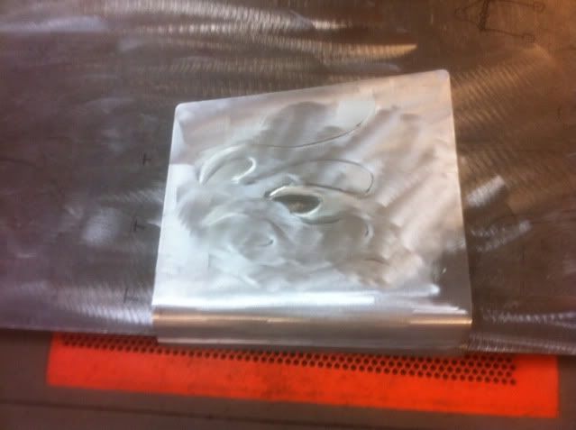

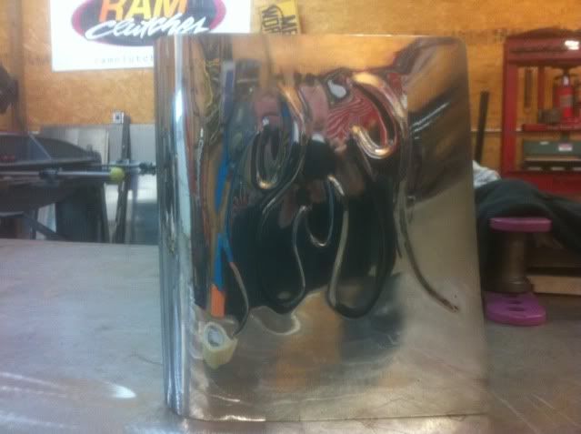

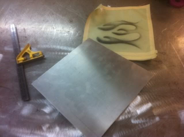

Here's what I came up with, I started out with 60 thousands aluminum.
After panel is cleaned up

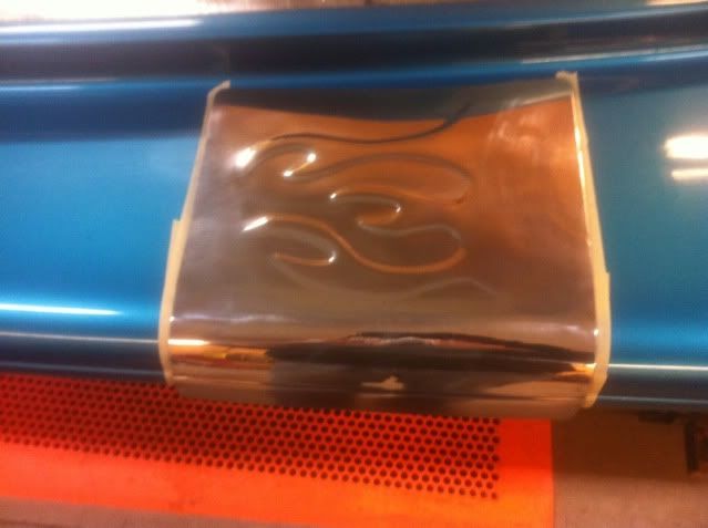

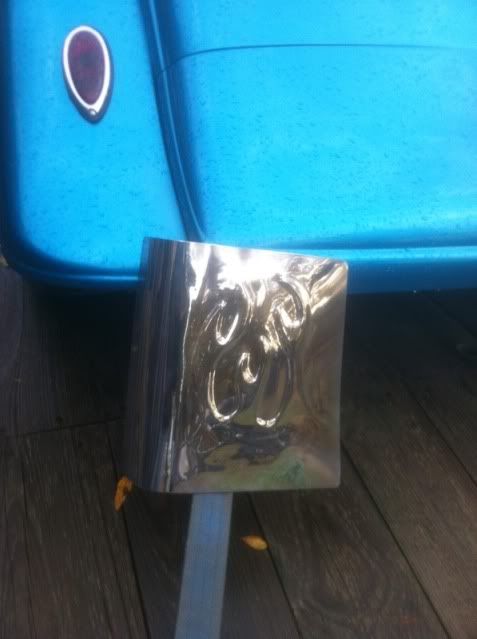

I was lucky enough to have a 34 Chevy running board on hand to be able to test fit and shape.
