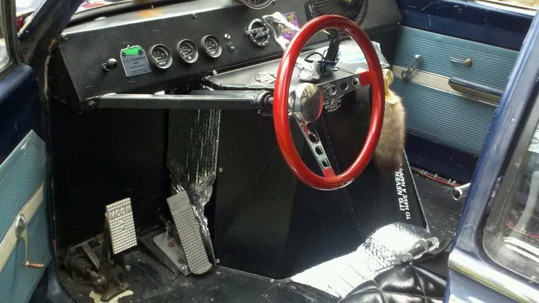

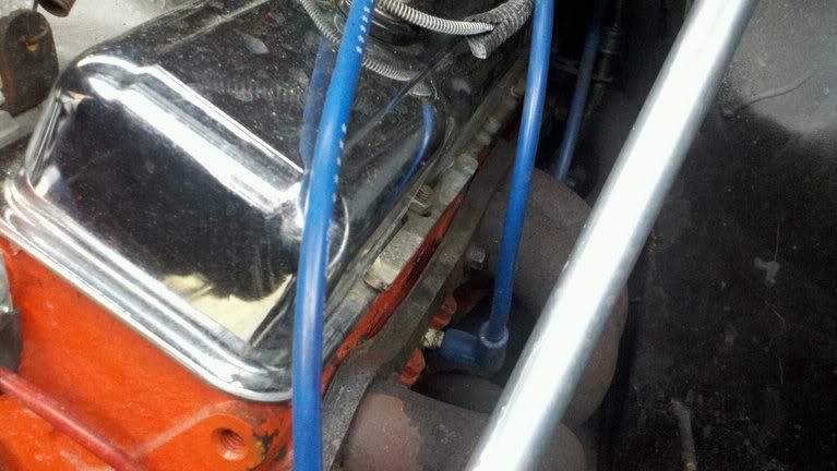

Currently I have "block hugger headers" that fit just fine..... BUT a "BIG BUT" is that they are so close to the engine cover that the amount of heat transferred from the rear of the headers to the cover is VERY HOT.
In addition to modifying the engine cover I would love to build a set of headers that would LOOK custom/cool and be "away" from the engine cover instead of right next to it. The rear tubes are so close on both sides that I don't think I can even get thermal wrap around them.
The car was built for 1/4 mile at a time & not for going to cruises/shows on 90 degree Summer days!
You can see what the heat does .....ouch!!!!
The more I look at the car the MORE I find stuff I NEED to do right now ..... in addition I also have LOTS of "WANT to do eventually things" !!!!
Lots of work to do.
13,732 Posts
The heat shield inside wont do much to stop heat, as the heat isn't reflected on the sticky side like it is on the foil side. You probably wont be able to find or build a header that will allow the tube to get much farther away, and still flow normally. I think I'd try pulling the headers off, wrapping them and then reinstalling them. It's nearly impossible to get a decent wrap on headers when the part that needs wrapping is always close to something.
