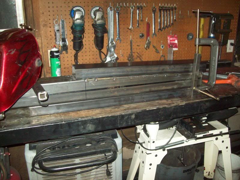

Where can I buy the hole saws & dies to drill & dimple frame rails like this?
Oh and in this picture he is tappering the frame rail down I would make a cut along the leading edge just below the curve and then in a kinda 'V' or pie cut make another cut at the angle I want the tapper...correct?

If you use a lot of cutting oil with your holesaw blades you can make them go a long way! DON'T buy cheap hole saws! I use Lenox or Milwaukie and have cut hundreds of holes with my set. The good ones I've even had resharpened for a few bucks a piece. Cheap ones will wear out on the first hole and nobody can ever sharpen them.
