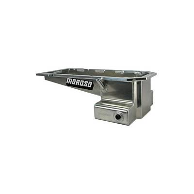

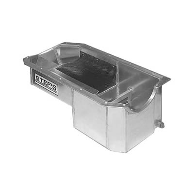

Good Idea..... I had remote oil filter kit (that used two oil filters) but never an oil cooler. In addition to helping keep the oil cooler the I'm sure it would look pretty "race-car-COOL.As for the finned oil pans ....... yes, most of the "stuff" we get today is made off-shore. :0( All the "made in USA" stuff is LONG GONE!!!!Most of the aluminum pans I've had any dealings with were ill fitting imports. I guess if you can find a quality oil pan it might be different....... Now a remote oil cooler would be of great help, and they can be easily plumbed into the oil filter position by using a remote oil filter kit, then plumb the cooler into the lines for the kit by buying one more line to go from the cooler to the filter. I've seen a few people do this for road race cars that run hard and hot, and it definitely works.
I've got a remote kit I had on my Camaro when I raced it, and took it off when I returned it to street only use. I'm toying with plumbing it into the Austin this winter when I do my next upgrades, and maybe an oil cooler too.
