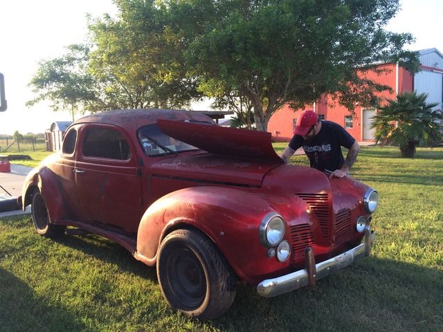

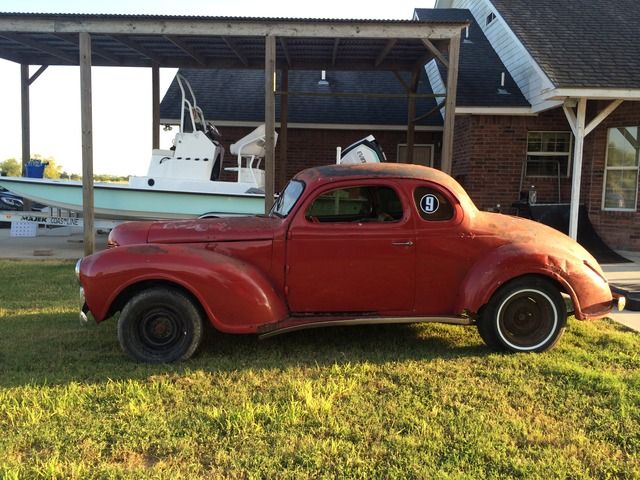

Hello guys and gals! This is where i'll post progress on my new project, the 1939 Plymouth Coupe Gasser. The story begins only a few weeks ago when my brother's father-in-law insisted that we drag home the old car. The Plymouth seems to have been an 80's era hotorod, currently sporting a Ford 289 or 302 (not sure which, not a Ford buff), a Ford Ranger front suspension, and a rear axle that could be out of the same truck. Everything is wasted, motor is locked up, front suspension is worn and rusty, rear axle looks scary, and the body has quite a bit of rust buried in bondo. My brother and I have been kicking the idea around lately of putting together a purpose built drag car just to play around at the local track on the weekends, I mean why let all those guys have all the fun? The first thing on my mind was getting rid of the crusty old front suspension and replacing it with a simple straight axle. Then ideas really started flowing, "Let's build a Gasser!" A long time friend had been converting his race truck into a street machine, and had a serious 454 just sitting in the corner of his shop. We picked it up for a great deal, and learned that it was a low compression motor that was set up for a blower. So, naturally I had to order a 6-71 blower :cool:. All this is happening very fast, and the next thing we know, we are picking up a super great deal on a narrowed Ford 9" complete with a full set of drag wheels and tires. The axle already has Mosier 31 spline axles, full spool, and 6:43 gears to turn the 34" tall by 17" wide Hoosier slicks. The front runners are matching spindle mount wheels with holes drilled for brake rotors, complete with Hoosier tires. Now we are really getting excited with this pile of parts in the garage, but there's still a lot to learn and many more parts to find. I'll share my experience here, and hope to learn as much as I can from you all. Plans are pretty much to swap a straight axle into the front, re-build the back half of the frame to go 4-link and use these meathooks, reinforce the frame wherever necessary, build a full roll cage (at least 8 point), and just patch the old body up and set it on the eventually killer chassis. Tonight we will get started tearing the front cap off, getting the interior out, maybe welding up something across the door openings to hold the body in shape once we pull that off. Any advice will be much appreciated, we are just kinda building this thing around deals we find.
Without further ado, here's some pics!

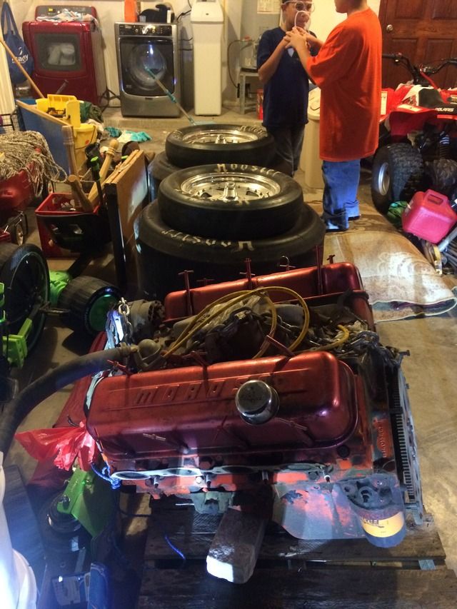

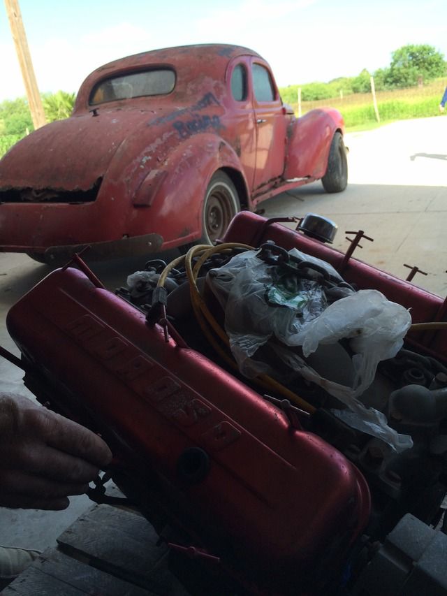

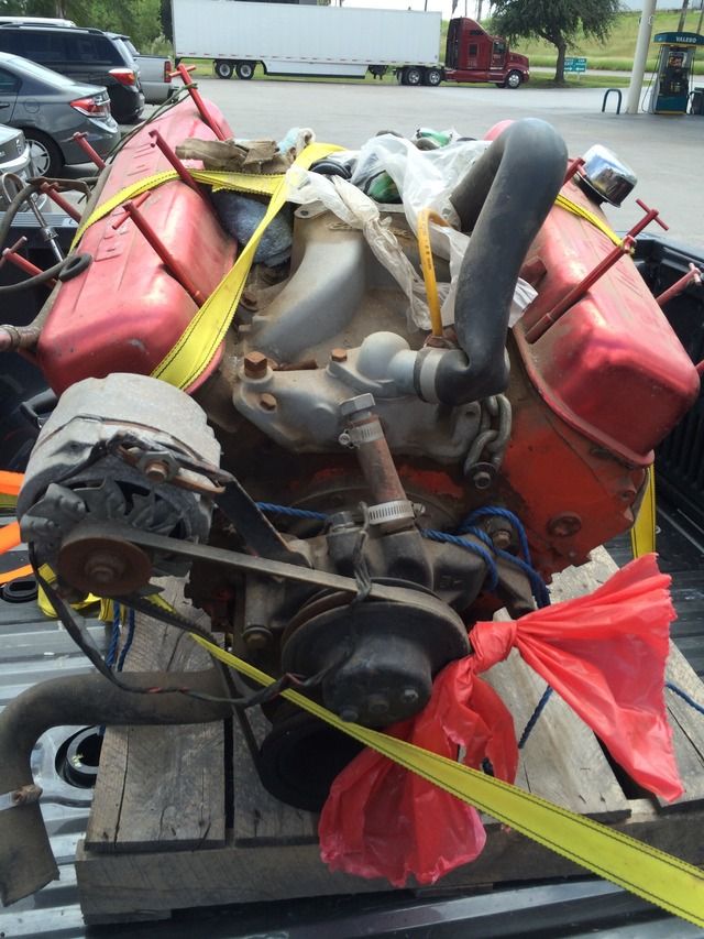

Last night we put together our new 1500lb rated stand and hung the 454 on it. Unfortunately, our buddy that we got the motor from couldn't tell us anything about the specs except that it was a "low compression" motor set up for a blower, hmmm. I couldn't wait to dig in, so we drained the fluids, flipped it over and pulled the oil pan. The oil was still honey gold, and the inside of the engine was beautiful. No slack in any of the rod bearings that I could feel, and it appears to be a forged crank. The rods look like a stock type of rod, but they are machined on the bottoms and really look like forged steel where it's cut.. I'm no expert in identifying cast or forged however, so I need to investigate further into that. The casting numbers on the block, 14015445, from what I can tell is a GM LS7 crate engine. I see triple valve springs in the heads, and heads are casting #836781. We'll pull the intake and heads next time and see if there any evidence of porting what the pistons look like.
Picture of the Crank and Rods.. I see no seam in the counterweights, which makes me believe the crank is forged.. Rods, not so sure? If it is in fact a old school LS7 crate engine, I found that they came with forged crank and rods. No telling what's been done over the years however.

The first thing I would do is tear it down to the bare block n have a look at the parts and how they are wearing. These engines had reasonably good internal pieces. A set of light, skinny ring pistons, balancing n a well camshaft should provide a good foundation for making serious power. I think those are dimple rods from your pic. Sounds like a lot of fun.
13,416 Posts
Looks like a good block, and not sure I'd tear it down if you know the seller and he says it ran well. The 781 heads are a pretty good head, and I'd look in the ports to see if they're still as cast, or have had any port work done to improve them more. They're a desirable head for street performance, but might not be considered a race performance head without some work. Sounds like the triple springs are an indication something was done. Might put dial calipers on the valves too, to see if they've increased the valve size also.

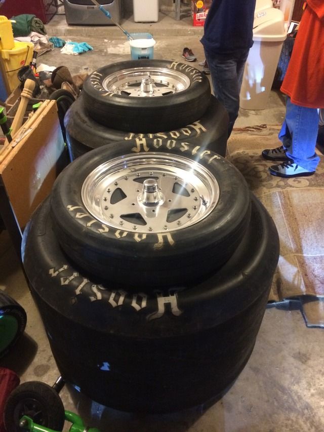

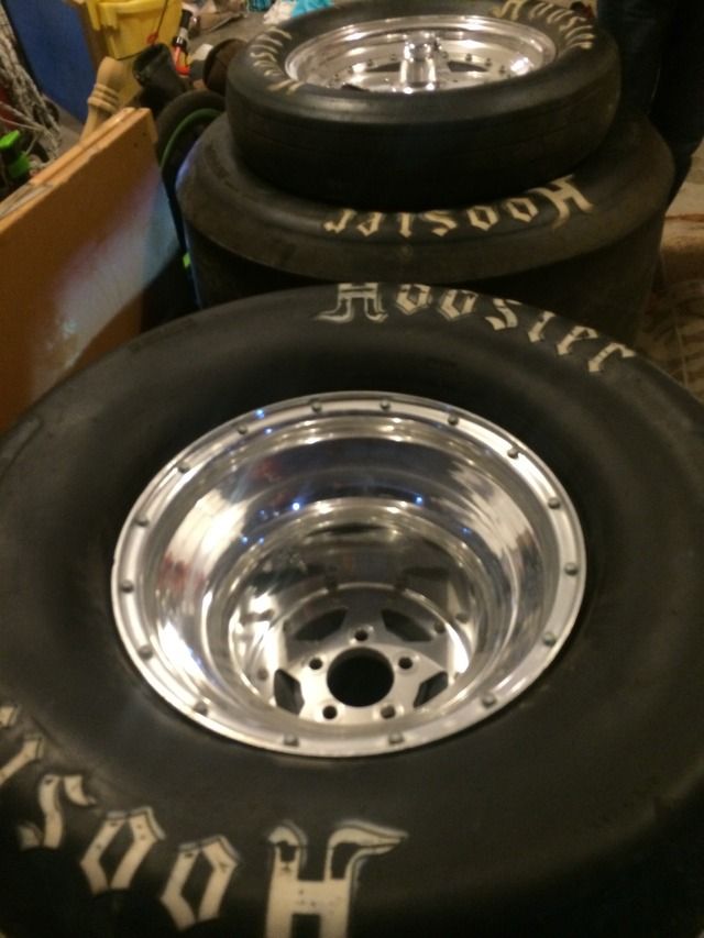

Thanks guys! We've been going over the parts we have, and hit our first snag. The front runners we acquired are spindle mounts, which I thought was really cool, but they are for Anglia spindles. After a little research I learned that these are not the wheels for me. Some folks have machined the Ford spindles down to fit the Anglia bearings, but I don't like the size of the Anglia spindles for what I'm doing anyway. We are going to have a big 7.4 sitting on top of these, scary thoughts. So it looks like i'll be buying two more front runners that will work better for my build.
