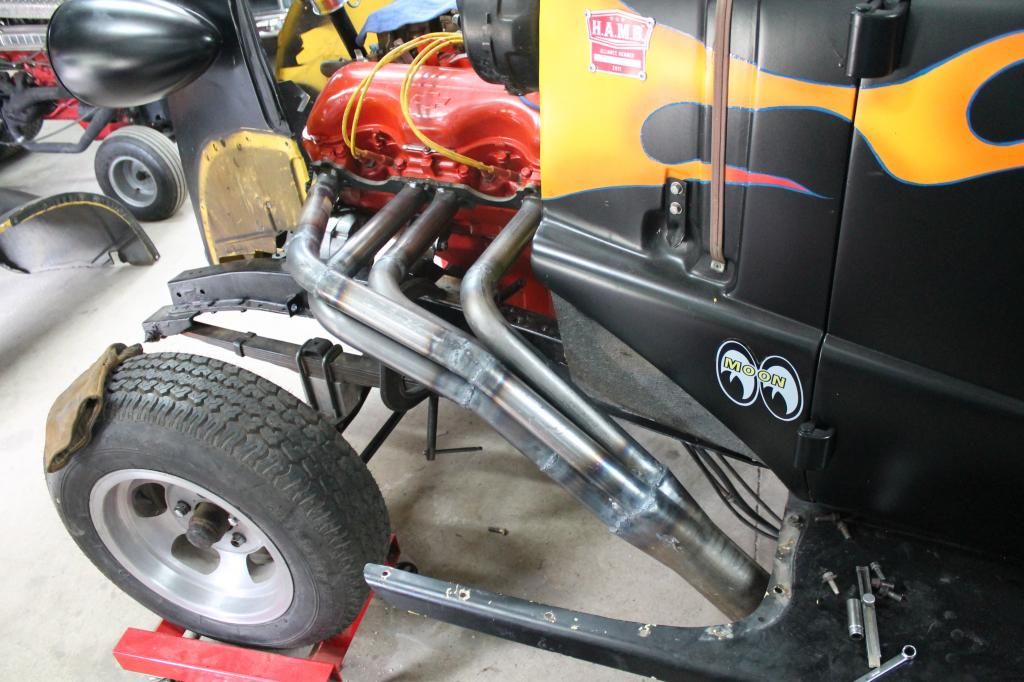

Home made fenderwell headers
Had the headers ceramic coated

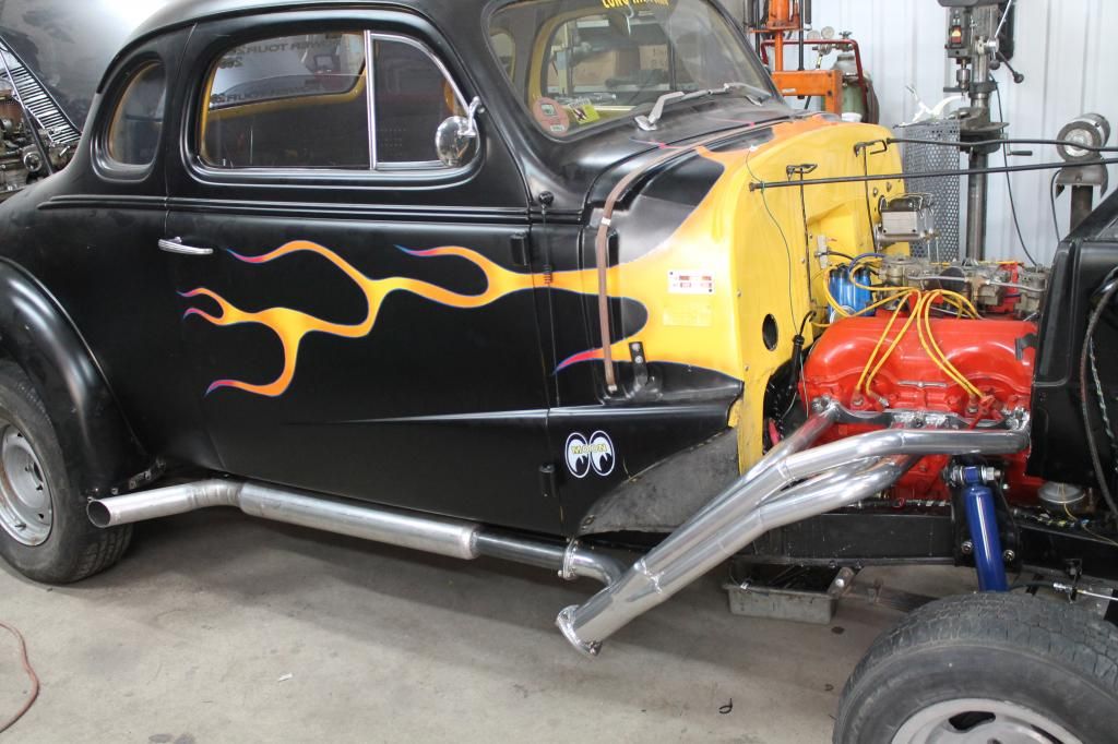

The radius looks good. I like your heat shields for the mufflers. Did you just roll some expanded metal for those?
30 Posts
Discussion Starter · #8 · (Edited)
Heat shields are 1/2" perforated 16 ga steel. A welder buddy has some left over from a job and he turned me on to it. I cut it with a cutoff wheel then rolled them in my home made slip roller. Worked out great and the price was right! Here's a better pic.
